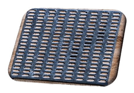

Machine laying the new ties. Note the difference between the new ties and the old. The new ones are thicker and have something on the ends. Does anyone know what it is?
It's a plate pressed onto the end of the tie to prevent tie splitting.
