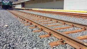

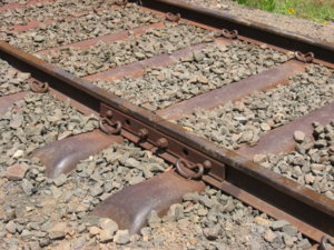

Probably more steel ties than people realize. At a glance, especially at a distance, these steel ties would pass for wood.
Bruce
215.1 KB
502.5 KB
Wow, they do look like wood. I'm going to look closer when I'm checking out tracks.
