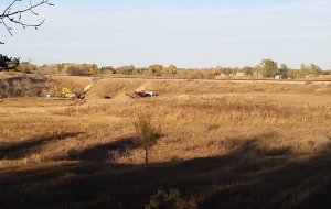

It sounds like it's the Form B scenario for sure. There is a curve in the tracks just to the north of the work site. A southbound train blows the horn right before it rounds the curve.
This is a pic of the work site - taken from the side of my front porch.

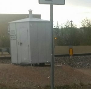

This is a photo taken from the crossing that is almost a mile north of the work site. This is a "yellow flag" as you stated?
I'll have to look closely along the tracks closer to the site - there might be red versions of this sign.
What a cool forum this is! Thanks for the info. It's great to learn more about how the train systems work.
That yellow flag designates a temporary slow order. The flag warning of an upcoming Form B would be half yellow and half red.
