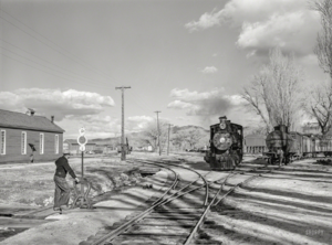

But... there will be a SWITCH to make this transition. I'm wondering: can anyone tell me how switching occurred in the 1940s in the USA? Was it automated at all, or did a human have to crank it into position?
Now, here's a follow-up question: is it possible for a train to "run through" a switch without jumping the track? If it's going fast enough, and it's heavy enough, could it just "force" the switch-over to the other track?

Yes, a locomotive could force its way through a trailing-point switch. That is where two tracks merge through a switch. It could seriously damage the switch, but it has happened in the past. Modern railroads have what are called Derails on many sidings and spurs to prevent this from happening, though they weren't as common during the time your story will be in.

In the 1960's in the Harmon shops of the NY Central, which is located along the Hudson River in NY about 25 miles North of the city they were using what the engineers called "rubber switches". They were designed to allow an engine and cars to pass through without damage. Springs in the switch mechanism would allow the switch to be forced by the passing cars or engine, but it would spring back into it's set position after the engine and cars passed through it. This significantly reduced the time needed to manually operate each switch as an engine and cars needed to move from track to track within the yard. It also reduced the switch maintenance in the yard. I never got to see exactly how these switches were set up for this, but it sure did save a lot of time. Not certain how long these were in place as I was not there very long.

yes they are manual
