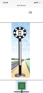

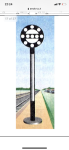

What is the track side sign in the middle of the screen on video #2? I have never seen anything like it in the US.

The sign marks dangerous place with speed limitation to 70 km/h on this case. This “dangerous” place was for about 100 meters only. Normally these signs are placed when infrastructure needs to be reconditioned and after repairs they are taken out. There are two different signs of marked dangerous place: starting and ending of dangerous place. Here you will find bellow images.
