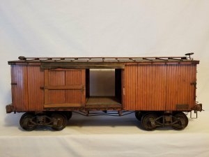

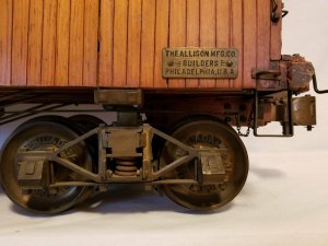

I came across this fantastic piece made by the Allison Manufacturing Company. I am trying to find out who they made cars for. I imagine they made cars for shortlines in the northeast. Thank you!
Thanks, Bruce. I have read that, several times. I have done the google thing. With the limited information that is available about this company, I am hoping there are photos that someone has seen, showing the builder's plate on a railcar somewhere, or maybe even a publication that is not on the www. Thank you!

According to an article in the Alexandria (VA) Gazette, dated October 30, 1900, the Robert Portner Brewing Company had contracted with Allison to built ten new refrigerator cars for the brewery, as well as repair the older ones currently in use. The MidContinent website said the company got out of railroad car manufacturing before the turn of the century, but clearly this is not the case. John, can I ask where you found those images of the model car??
