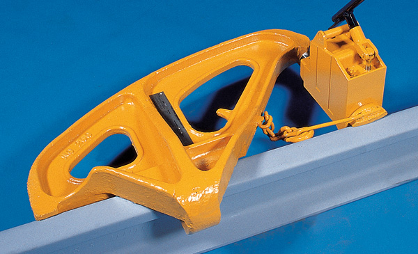

Modern rails are a lot more "bendy" than you would think. Their strength is vertical, not horizontal, and will bend to pretty sharp curves if needed. Also, "light rail" isn't as heavy-duty as standard class 1, 132 pound rail, which also helps the Bendiness.
Here's the modern way:
The old way, rail was often bent on site with screw jacks.
