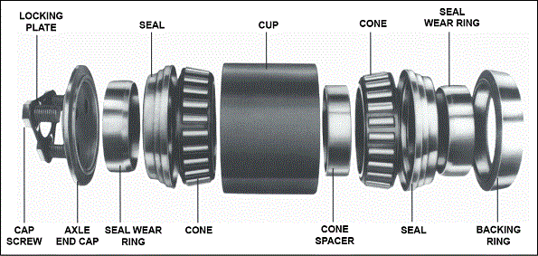

I think I could if I had old spacers and some drillbits and maybe a angle grinder I could make the appropriate grove enough for an experiment on either an axle bearing or a mock axle bearing to heat up and then show how it would work it could be done relatively cheaply. It would take a little bit of work, but it could be done.

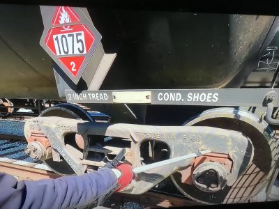

Here’s a bearing pic. The other pic is where the spacer sits above the bearing and making contact with it.
