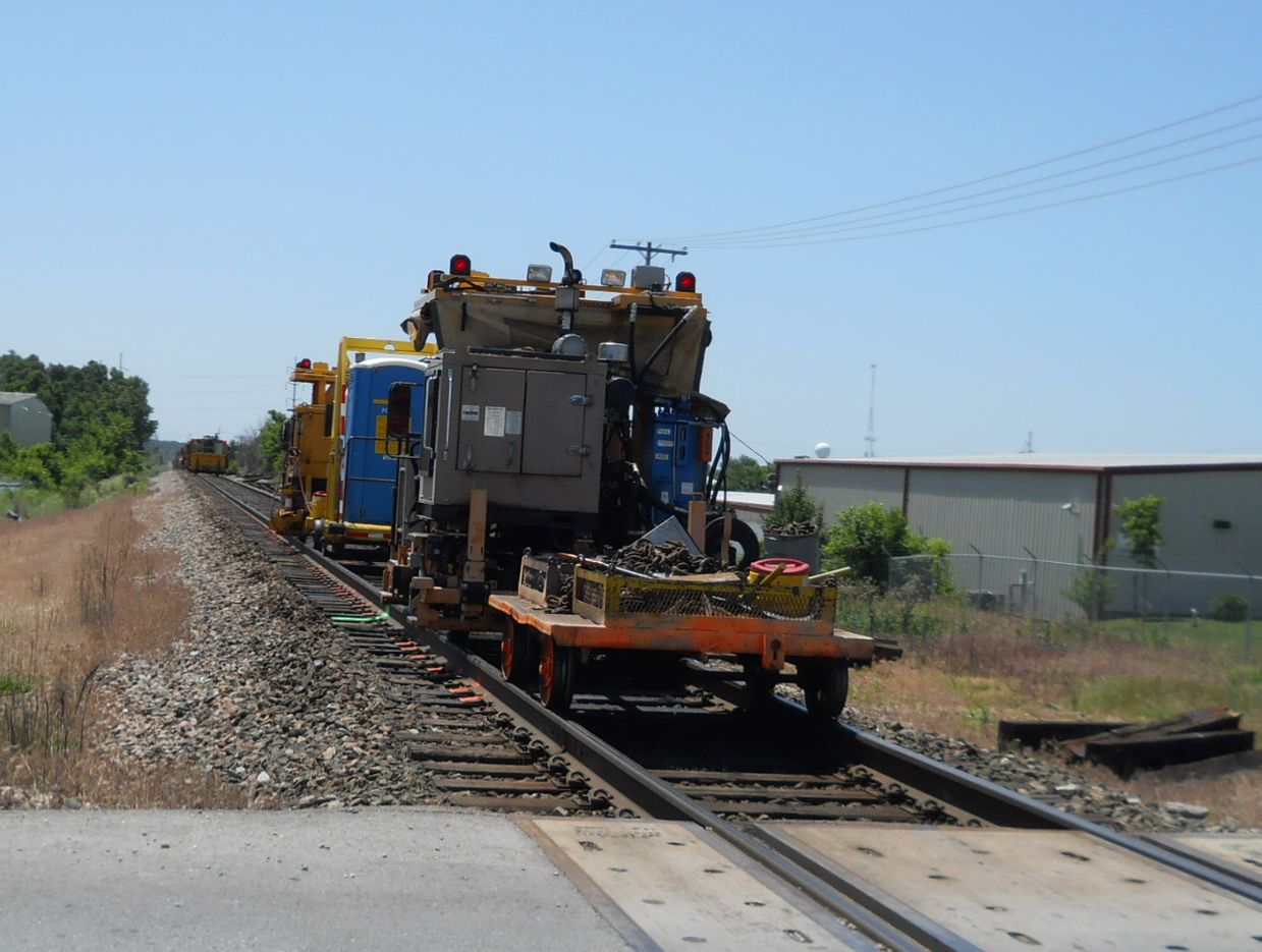

What do you call this?
mobarbq
New Member
Taken at approximately 1230PM CDST 21 May 2012 at tracks at E. Division Street in Springfield; two miscellaneous vehicles southbound on tracks.
The first bore a "porta-potty" - had never seen this before, and the one behind it seemed to have some sort of sucking mechanism engaged.

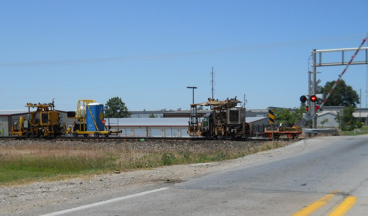

Also have a picture taken from the end, as the two proceeded south on the tracks.
UP Scott
Active Member
Hey Mark, long time for me, but just what gets squezzed? In the link picture it looks like the tie plate gets aligned with the tie, but if the spike is already in place, what moves? BTW, is Tie Plate and Anchor the same thing in this case? You MOW guys always have the coolest toys don't you... :D
The machines are anchor adjusters made by Racine Railroad Products.
http://www.racinerailroad.com/PDF/Dual_Anchor_Adjuster.pdf
The two machines in the pictures are near the end of the tie gang and are squeezing the rail anchors tight against the new ties.
Crow
Member
No, a tie plate is what sits on the tie that holds the rail. An anchor is a clip on the rail that is tight against the tie. Spikes keep the rails from moving out (wide gauge) and anchors keep the rail from moving laterally.
